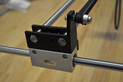

I'm on iteration 2 or 3 on most of the parts so far (since this is a learning experience for me, too). The second iteration of the NEMA17 holder is pictured above -- it has mounts to fit in standard 20mm t-slot, and is reversible, so you can flip it around (for the other side).
The idler design is very simple and low-cost, but I'm not sure it will end up working in the end. Here, instead of a bearing, the idler cog simply slides upon an M5 machine screw, while two jam nuts ensure that the screw holds in place and doesn't move. This seemed to work great before I started tensioning the belts, but now there appears to be quite a bit of friction, so I'll likely have another look at this design, and try to find some small (inexpensive) bearings.

Perhaps try using an M5 shoulder screw instead of the machine screw. You really shouldn't be spinning a wheel on a threaded shaft; not only is there a lot of friction but also it will wear out very fast.

The shoulder screw with a bit of grease is definitely a good idea (and one my dad had suggested), but given how well the pulleys spun without the belt tensioned on just the raw bolt, I decided to give it a try. With the belt tensioned there's a great deal more friction coming from them, so I think I might skip the shoulder bolt altogether and try to find a small 5mm bore bearing -- just to ensure that there's as little friction as possible. (There's already such low friction with the ball bearings on the linear axes, it seems a shame to add so much with the pulley if you don't have to).
