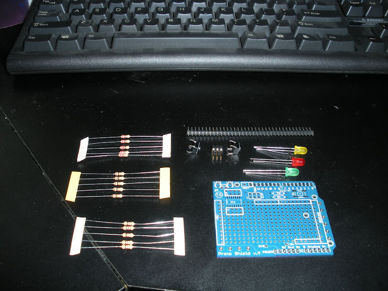

Ok back to shields, I ordered a shield kit along with the netduino to experiment with.

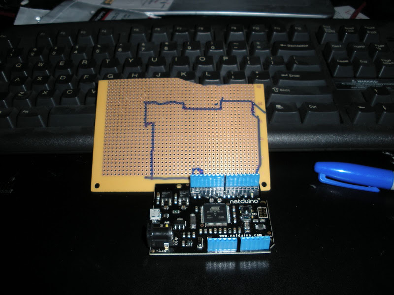

Running down to the local consumer electronics store I was able to procure a perforation prototyping circuit board with equally spaced holes 0.1 inches apart.
Perfect quick cheap solution? Ah not so fast; there is a fly in the ointment when come the Arduino form factor! It turns out that the Arduino is only partially laid out on the 0.1 standard grid!
The ones that are, are the power pins and analog pins on the bottom of the board and digital pins 0-7 on the top side of the board. Everything else seems to be offset 0.05 inch off of the standard grid, as you can see from the close up picture with the two jumper wires.
Since my project serial cable interface project did not involve the upper range digital I was still free to proceed. So using the one proto board as an outline, I took a marker pen and drew around the basic outline and used a band saw to cut the board. If you do not have such a tool a hack saw could still make short work of it.
So in short order I had created my serial cable interface shield with a couple of big mistakes as my first effort.

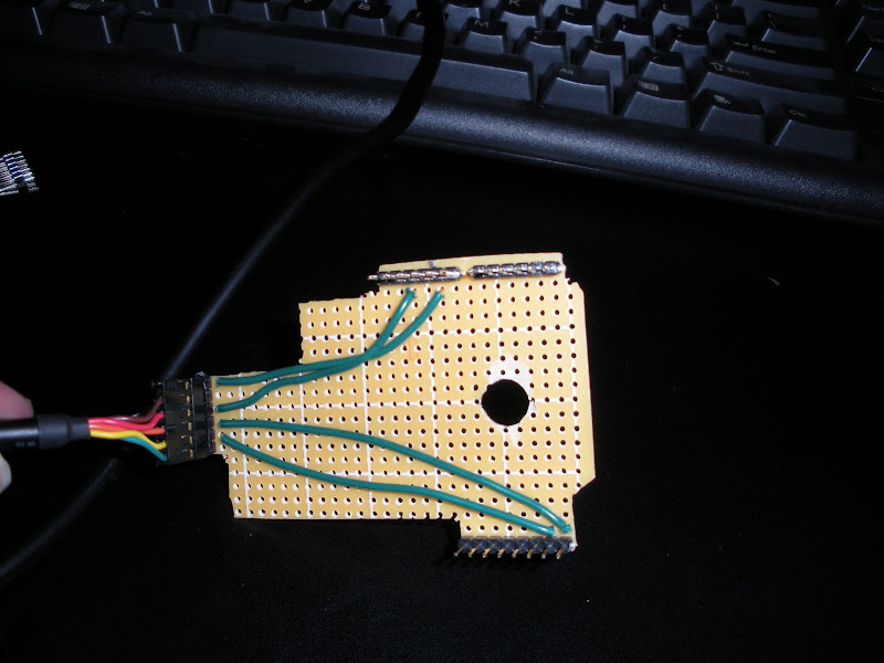

Ok what were the mistakes? First off I made a cut out for the power plug as I had noticed that the circuit board wasn’t flat when I did trial fittings on top of the Netduino with pieces of wire to test alignment, not realizing that connector pin strips would offset the board just enough to clear the power connector.
The second is that I put the serial interface on the centerline of the board which seemed logical at the time.
However in doing so, I covered up access to the USB port!
Ok back to the drawing board, here’s how I would make a second attempt.
I then got extremely busy at the day job and wasn’t able to return to this for a bit. In the meantime I decided that I didn’t care about it being nice and neat and here’s the next iteration.
So another quick trip to the band saw to flip the connector up on top and some quick hot gluing and problem solved!
As to the upper digital pins not being in the 0.1 registration layout you can do like I did and simply make a cutout for them; then use a pin strip with wires to come back to the main area of the perf board.

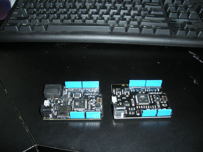

The netduino family currently has two members. The base Netduino and the Netduino Plus that has a micro SD card and Ethernet interface on board.

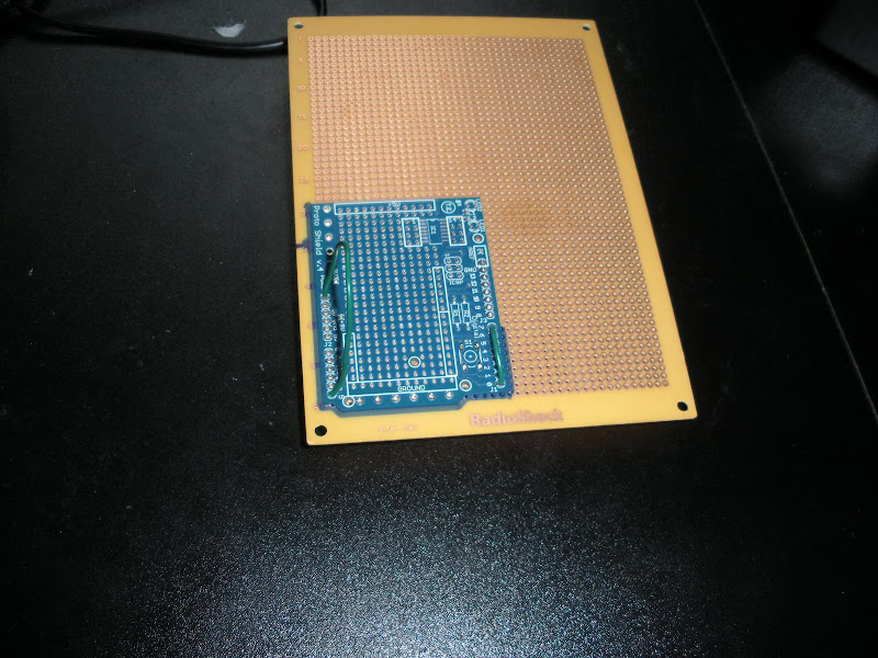

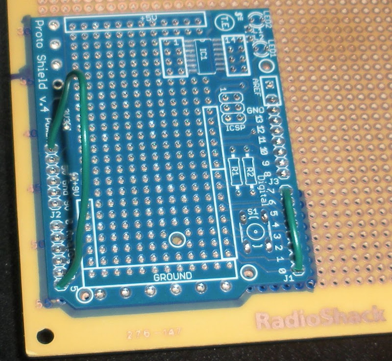

| From netduino |

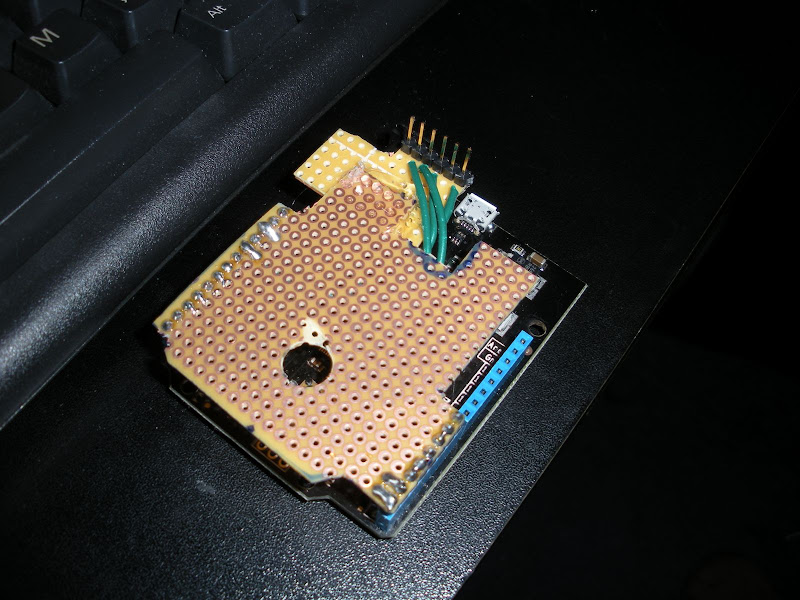

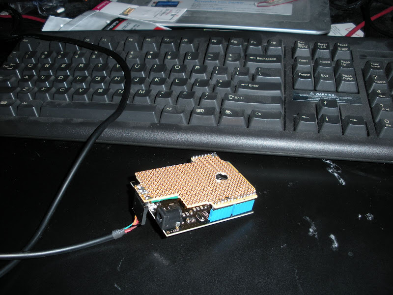

| From netduino |

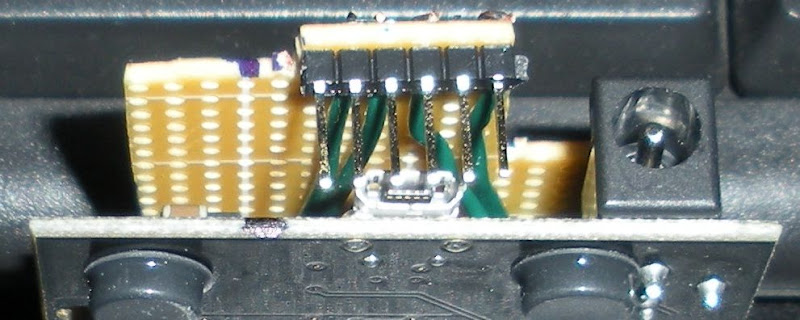

| From netduino |
