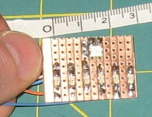

I spent some time saturday working on the prototype encoder electronics. I originally created a simple test board with two photo-transistors and a single LED to see if pursuing it further would have likely success.
This effort resulted in this simple board; one LED, two photo-transistors.
Today, I went further, since the test board could detect a white/black edge printed on my inkjet. I made a 6 photo-transistor device using ordinary stripboard; still one LED, as these things produce a LOT of light. The reason for so many photo-transistors : the tranistors create pairs of voltages that a comparator will use to decide which one is looking at blackness, and which looking at white. Using two in this way reduces the effects of ambient lighting, ink reflectivity variations. Two pairs will provide Quadruture encoding, and the third pair will decode digitally printed absolute position markers.
Here's a more wide-angle shot to give an idea on the size of these components. The 6 transistor board is a bit longer than I wanted, but I still think it will work, and doing it this way allows a larger margin of error when I print the encoder wheels.
