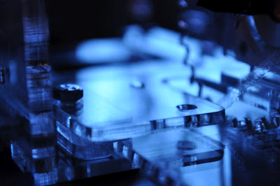

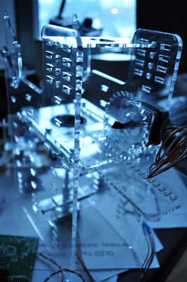

i designed a new enclosure for the SLS printer that would let the build chamber, z-axis table (inside the chamber), pivotable mirror, laser, powder feed system, and electronics all fit together. i've been designing the system with the hopes that it would be both easily created by others and inexpensive, and so currently the whole system is essentially just a whole bunch of laser cut acrylic parts, a bunch of inexpensive steppers, and a trip to the hardware store for some bolts and ABS pipe. (i have some thoughts to design a laser-cuttable gimble system for the pivotable mirror, but that's a bit in the future).
the pivotable mirror just rests on top of the sides, which are set at 45° and directly above the build chamber.
one of the things i've been really trying to be creative with is the powder feed mechanism. traditionally, a commercial SLS printer will have two chambers with indexing z-axis tables, and a roller. one chamber will start with a thin layer of powder (the build chamber), and the other will start with a large amount of powder (the material supply chamber). after each layer, the build chamber will index down a little, the supply chamber will index up a little, and a roller will roll new material from the supply chamber to the build chamber.
the key elements here are supplying the build chamber with a thin, repeatable layer of powder, and having a lot of supply powder. i wanted to try and avoid having *two* chambers with indexing tables, as well as a roller (it seems like a lot of extra space and mechanism, if you can design something functionally equivalent). the system i came up with is as follows: a thin piece of acrylic rests on the platform above the build chamber, and it can slide back and forth overtop of the build chamber using a rack and pinion system. the sliding sheet is sandwiched in so that it can only ever move back and forth over the build chamber (not side to side, or up or down), such that if a layer of powder were put ontop of the build chamber, it would wipe off any that exceeded the height of the chamber itself. (this whole sliding thing is essentially the roller, but more of a squeegee)
in that sliding piece is also a long, thin slot. ontop of this slot one would put a little hopper full of powder. when the table indexes down, the slide will slowly slide over the chamber, the powder will fall down into the chamber, and ideally the slide will wipe away any that exceeds the height of the chamber. that's the idea, anyway. :)

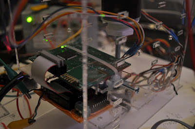

the electronics are mounted under everything, with easy access. i had a few spare boards left over from a batch sent to goldphoenix that used a dsPIC33FJ256MC710 on them, so I repurposed them (since they have a breakout header for about 30 pins!), and plugged it into the little 4-axis stepper controller board from the previous post.
the sides were designed with lots of slots and holes, so that little extra bits could easily be added or removed or modified later without drilling anything. it's really handy! :)

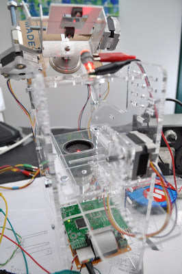

here is the (almost) whole system, with a red laser pointer being used as a test.
(the stuff in the build chamber is actually the foam top of the table -- there isn't any powder yet. i hope the foam table will act as a bit of a seal, too, and prevent much powder from escaping below).

after over-voltaging a bunch of DVD laser diodes, and taking apart a bunch of laser pointers for their collimating lenses, i've decided that it would just be a lot easier and more precise to find a pre-made laser module (and, so, i've been looking around ebay for one for the last week or so). i'm thinking 250mw minimum (like the DVD laser burner), but there are bunches of inexpensive 808nm 1000mw diodes on ebay. since these are near infrared, there's a much better chance that they'd be able to work on materials other than pure black plastic, and the additional power means a bunch of good things, including that each layer could be sintered quicker. (unfortunately it also means that one's eye could be damaged even that much quicker -- and the infrared lasers border on what is visible to the eye, so it's a bit more dangerous than a visible diode).
any thoughts for a complete (inexpensive) laser module with a collimating (or focusing, or both) lens would be fantastic, and as always i'm happy to hear comments/questions, or thoughts on where to find very fine ABS, nylon, or other thermoplastic powder.
