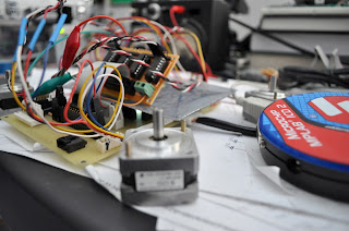

i decided that rather than go pickup a spare gen3 electronics set, i'd just build a stepper controller board and plug it into a dsPIC breakout board (thinking that the printer will need at least 3 steppers -- two on the pivotable mirror, and one to index the table, plus however many other motors for laying down new layers of powder).
i picked up some L293D H-bridges, and after a good afternoon had a 4-channel stepper controller (or, alternatively, one stepper channel could be used to control two DC motors). around this time i also remembered how very long it takes to build things on perfboards with through-hole components, and how much time surface mount components and the folks over at gold pheonix have saved me in the past couple of years :).
the stepper controller can take separate voltages for the two left and two right channels, although one channel has to be between 4.5-7v to supply logic voltages to the L293D H-bridges. it also supports both unipolar and bipolar steppers -- i just added two pins to the 4 stepper header that supply the motor voltage, incase it ever needs to be used for unipolar steppers.
after some tests plugged into the dsPIC33FJ256MC710 board, i decided to start working on the pivotable mirror mechanism. the pivotable mirror has to reflect the laser beam through variable angles such that the entire print space of the chamber is accessable, and at a sufficiently high resolution to be able to print things (not that we know what that resolution has to be just yet, so higher is better, while still maintaining some speed. in the event its too slow, the laser diode could always be pulsed, too).

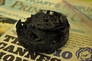

i've decided to try and make some ABS plastic powder, since it seems really difficult to find ABS in powder form (it's most commonly granules, filament, or sheets). i'm thinking of a belt sander or some of the options mentioned in the comments on the last post -- the trick is that the whole SLS printer has the best chance of working when the powder size is very fine. we took a bunch of our failed prints from the repstrap and put them in a pop can to melt down with a blow torch. not the best option, but it's freezing cold outside, so slow cooking them under a candle or something similar likely wouldn't work. it's almost melted in spots, and i'd like it to be pretty consistent before heading to a belt sander:

Regarding "chemically grinding" the ABS, a lot of folks have suggested reading Forest's post about acetone, but if you read it through including the comments, note that it appears as though a few different parts seem to come out of the mix, and one commenter suggests it's actually taking apart ABS into its component parts (which wouldn't be too good). I'm also not sure if it would strip the pigment from the mix, but that seems likely, and its critical that the ABS powder be black for these experiments.
