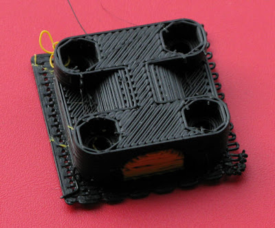

To follow on from the basic twin extruder test in the last blog, here we have the results of my first test using support material
The machine is loaded with two colours of ABS, mainly for convenience at this stage, Black for the object and Yellow for the support material.
The file chosen is a bearing cap, printed from the bearing axis up, this has a semi-circular void that runs front to rear of the part. Actually this file prints very well without support material but it is a small part suitable for testing the head change.
Small it may be, but it still contains a fair number of layers and therefore lots of head swapping!
The first test was done with a hand edited file, I added several new lines of G_Code to manage an orderly change over from one head to the other. On more complex parts, it would not be practical, the new codes need to be added by Skienforge.
Skienforge already deals with support material by issuing a temperature change to flag the start and end, I need several other codes inserting at this point. To do this I have made a simple modification to Skienforge to pick out the support material, then insert my new codes as required.
The image shows the first complete part made by running the file from Skienforge.
Finish on the part is crude as the G_Code has been generated with 0.4mm layer thickness, this ensures a relatively quick build and gives a manageable file size.
The print is far from perfect, but I have to say I am encouraged by the results.

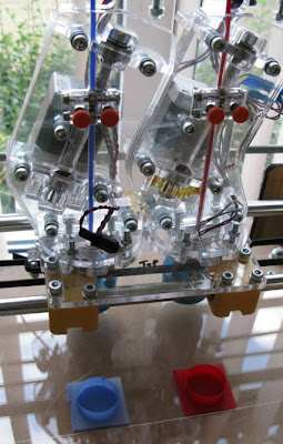

Colour Printing
First attempt at two colour printing, not the most astonishing object but you can see the potential.
The print has been done on a BfB V3 machine fitted with twin extruders. The two single colour objects were printed together from one file, the two colour object by swapping heads through the build, changes triggered by G_Code.
You can see the potential for running support material along with the main print, swapping seamlessly back and fourth between the two.
The wall is single filament thickness so alignment has to be reasonably good between the heads. The object is far from perfect as its only the third print of a new machine fitted out with the twin head.

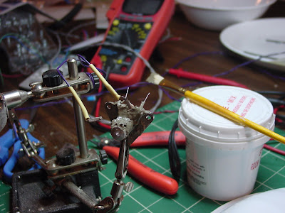

Working with Cotronics 907
I let the first application of Cotronics 907 on the Rapman extruder barrel air dry overnight. The material was quite hard. The next morning I used some fine grit sandpaper to smooth it down so that the mounting flange could slide over it. It took some time to smooth it out sufficiently, but you can see that it dressed dowquite nicely.
I was also able to dress the PEEK thermal break so that it fit into the extruder barrel socket firmly without jamming.
Unfortunately, I read the oven curing instructions incorrectly and encountered a problem that the Cotronics people were very open about with this product. If you don't cure it properly and heat it too hot and too fast, it tends to form blisters which separate the ceramic slip from what you are putting it on. Thus my careful sanding and dressing of the flange joint was for naught. It is worth noting that once I saw the bubbles I was able to remove the 907 with the wire wheel on my bench grinder relatively easily while it was still warm.
From there I applied a second coat, this time with the flange in place so that I wouldn't have to do any sanding. Doing it that way I was able to put the basic underlayer for the nichrome heating coil, the flange fillet joint and the flange pad all on at one go.
After four hours of air drying, two hours curing in my fan oven at 90 C, another hour of post curing at 120 C and a final post curing hour at 200 C, I was able to secure the nichrome heating coil as per BitsFromBytes instructions on yet again.
On that I put a slip coat of 907 and after it had air dried was able to put a coat 907 to secure the leads for the heater as per BitsFromBytes instructions. I was also able to place the thermistor in its socket as you can see from the following picture.
Using the "helping hands" electronics jig, I was able to secure the thermistor leads and the extruder assembly. This was very handy because it let me monitor the assembly for shorts in both the heater coil and the thermistor while I was applying the 907 ceramic adhesive.
I will be letting it air dry till morning after which I will do the 8 hour curing and post-curing in the fan oven. Hopefully, I didn't overdo the ceramic application and the curing will be successful.
