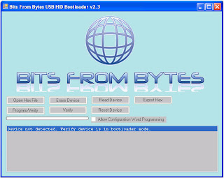

The last couple of images are of the Windows application that controls the USB Boot loader.
Its very easy to use.
First step is to power up the controller board while holding down one of the switches, this initialises the USB interface and displays the screen message.
Start the windows application and if the board is in boot mode it links in.
Once the coms are up and running point the application at the HEX file and download.
Resetting the board allows the new file to run.

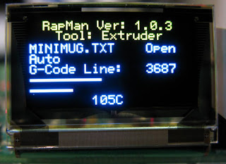

The top pictures show the screen activity during normal running, the BfB logo on power up followed by the run screen.
The run screen is showing Firmware version number followed by the tool type found. We use an analogue input on the board to read a static voltage returned by the device attached to the tool header. The voltage is prefixed with a resistor that is unique to each of the tool types that may be fitted.
In this instance it has found the device attached and returned its type.
The tool type is used throughout the code to enable appropriate control.
Top of the Blue section of the screen shows the file being run is MINIMUG.TXT, this field changes as we jog through the contents of the card. The “Open” flag indicates the file status.
Below this we see the machine is in AUTO mode running the txt file from the SD card. We can switch this to MANUAL at any point and move the head using the axis buttons.
G_Code Line needs little explanation, it simply is a running line count of the G_Code lines executed.
A solid bar below G_Code Line represents the print progress, we can see at this point we are at line 3687 in the file and this is just a bit less than half way through the print. The bar reaches the right hand side of the screen when it gets to the end of the file.
The shorter bar below, is a representation of the step buffer contents, this line flicks side to side as the fill status of the buffer changes. The status is reported just before the code renters the Bresenham routine where its contents are replenished. As it stand it looks like the buffer is still about 25% full after preparing the next line ready to run. I don't know if I will leave this in, it was useful during development to see a more or less real-time status indicator, there are probably more interesting things to show on this line.
The temperature reading at the bottom is the current extruder temperature,measured by the thermistor, its low as the pictures were taken with the board on the bench during test.
One thing to note is that the screen is small, the pictures make it look huge, the actual size is about 25mm wide x 15 high (128 x 64pixel.)
For those with an interest in the screen, the contrast is fantastic, the text is small but very crisp and clear.
