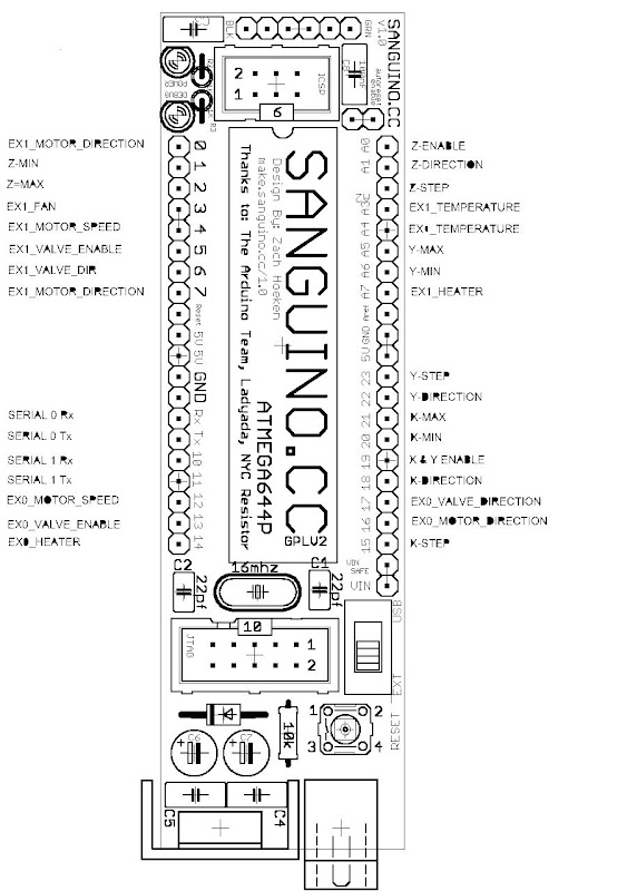

This was done some time ago but seeing other folk using terminal strips for connections reminded me that I needed to blog it.
For the PlyRap I purchased a Sanguino to control the machinery. A quick look at how many connections I needed to make (and perhaps remake) as I experimented meant that the on board 0.1" solder pads would be quickly used up or put beyond re-use.
The solution above was to find some 0.1" pitch screw terminals (and as I am using a re-purposed ATX PSU, a floppy drive power connector) and bring out the connections to these. I mounted the connectors onto strip board made the neccesary connections for the power connector and soldered the Sanguino to the board using 0.1" pitch SIL header pins.
