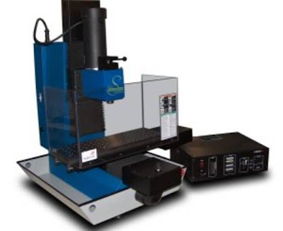

The students have access to a Pro Light 1000 mill which is used in a lot schools here in the states. It has an attached interface box that has I/O ports that are controllable with M codes that we will use to interface to the extruder controller.

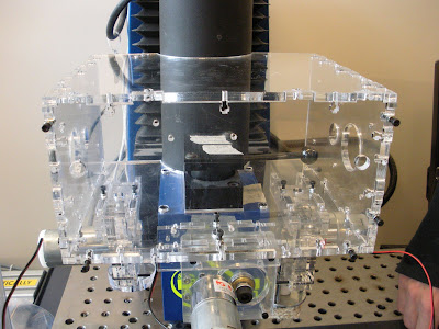

The design goal is to be able convert the mill to a repstap by simply placing a drop on platform that holds multiple extruders for potentially doing multiple colors or building duplicate objects at the same time. The base design holds three heads and has provision for wingman extruders out to each side for objects that are less then 140mm in width.
From Roosevelt High School RepRap
Ultimately the front plate will be obscured by the PCB boards for the electronics. More to come!
