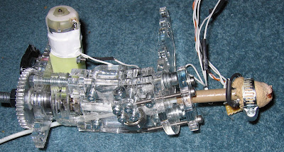

The M8 bolt in my BfB extruder hasn't been gripping the filament well. I've tried the standard tricks, sharpening the thread, increasing the force (until I cracked the acrylic), but I'm still able to pull the filament out by hand against the thread. While shopping around, I came across some coach bolts with much deeper, sharper threads. Simple replacement of the M8 bolt was difficult - there aren't nuts that fit and it was impossible to attach the existing gear or provide vertical support.

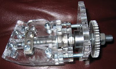

I needed a bolt with m8 at one end for the gear and bearings, and coach bolt screw at the other for the filament bite. So I made this:
It's soldered together ( see pictures for more detail of how), but if I had an extruder I could easily have made a coupler, since the joint is in compression.
It seems to fit OK into the BfB assembly, with a little modification of the bearings (one bearing, rearranged nuts to fit). It grips the filament lovely now, and hand-winding the gear drives the filament well.
I then attached my rebuilt extruder nozzle.
I'll post results later when I've tested the nozzle.
