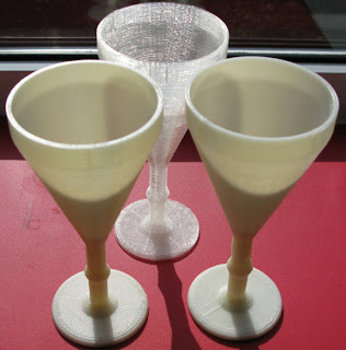

I finally managed to get hold of a roll of ABS from Ian, he has been printing ABS for some time but I have only done a few test prints.
To run the higher temperatures I have made a new hot end, the old one had PVC wire insulation in the hot zone. It also uses PTFE insulator with backup ring to stop it pushing out of shape with the high temp.
I have also experimented with the finish and material of the print table to see if I could get away with using MDF. I found there was good adhesion for the first one or two prints then you have no chance. The ABS seems to stick to a fresh clean surface but when the first print gets peeled off, so does the surface finish. Options then were to turn the board to a fresh spot for the next print, this works but is tedious. I also tried taking an “old” board and resealed the surface. I tried PVA adhesive, a very thin layer (undiluted) all over the surface with the excess wiped off. This worked very well, probably better adhesion than untreated MDF. But, the first print peels off the surface again.
I have now switched the board to Acrylic, this seems to be working, the first few prints were very difficult to remove, but now it seems to be settling down, I will let you know if this is a long term solution. I should also say that I am very late getting into ABS, have any others tried Acrylic for more than a couple of prints? The same spot on the Acrylic has been used about 8 times.
Note, on the new board I ran the first prints at 200C and these were very hard to get off, now the surface is matt finish I can run the first layer at 225 to 230C.
ABS boards are always an option but price is an issue plus we are already cutting acrylic so to run another board is very easy.
Print Temp is 235DegC measured at the tip, print speed/extrusion speed – 16mm/sec
No raft, continuous extruder running.
(V3 BfB machine with PIC32/SD control)
Its still early days with ABS, these first items show promising results, I need to get some more material through the machine to fine tune the settings and explore higher speeds.
The new V3 machine is capable of running 64mm/sec, Ian has printed at this speed, quality definitely suffers but the machine and software keep up. I don't intend to go anywhere near to 64mm/sec it is extremely hard on the machine. 24 to 32mm/sec would seem a more realistic maximum, I will post results as time permits.

Whew! VERY nice print quality!
where do i go to get ahold of that wineglass model?
also, i'd love to look over the firmware. is it in subversion?
one more question: what are you using to generate the gcode with no extruder on/off toggles? are you using skeinforge?

Zach, the wine glass is attached, see how you get on with it. Maybe you could add it to the parts repository for me.
I use skienforge for all the G-Code files but when I interpret the code I do not switch the extruder off. I find that once it has been turned off there is a lag in getting reliable flow going again. I know this can be compensated for in skienforge but when I tried it it did not seem to work as well as running it constantly. If you look back through my blogs I have never turned the extruder off during a print and made a point of mentioning this in the notes. For me its less of an issue to deal with a few hairs than a void in the print. Give it a try and see if you get the same result. I have a feeling that Chris runs the extruder all the time, maybe he can confirm this.
