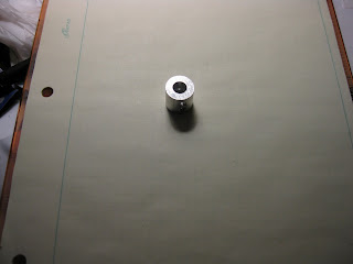

Extruder Madness Part Deux!
I've been kicking around an alternate extruder idea for a while now and have finally gotten around to putting it down on "paper." Ah, the joys of late night caffeine to clear up a headache!

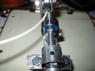

The goal was an extruder with no specialty parts. Everything can be obtained from your local hardware store which is exactly what I did. The only tools I used was a cordless drill, a vice, a bench grinder, a small bastard file, and a 10-32 tap. Keep in mind that this does not include the heater barrel which is a separate problem that I'm addressing.
So, here's the extruder. Yes, it extrudes quite well. Put a couple feet of 3mm ABS through it with no problem. Hadn't even bothered sharpening the threads yet but that would certainly help also.
This is basically a take off of the lasercut extruder design, the 608 bearings and such, but without any need for the specialty parts. The design isn't as heavy as it looks though it does have a bit more weight than the Mk II. For my machine it wouldn't be a problem though ymmv.
Here's how I put it together. Very little text from now on.

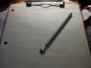

Cut head of of 5/16-16 x 5" screw.
Assembled the 608 bearings (Drive Bearings 1 and 2) on the drive screw.

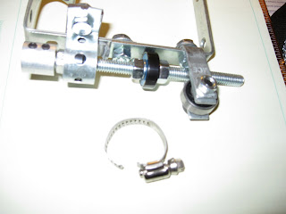

Took a 1/2" aluminum cable crimp, drilled and tapped it 10/32 for two set screws and drilled one end to fit the extruder drive screw and the other to fit the GM3 gearmotor shaft.

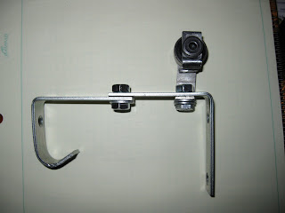

Next I took three small L-brackets (maybe one inch on a side) and bent them as follows. I then drilled out their holes to fit an M6 shoulder bolt. This along with a shoulder bolt and some washers makes up the Pressure Bearing assembly.

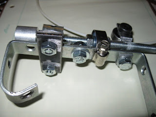

I then assembled the frame to which everything mounts from two 3" L-brackets.

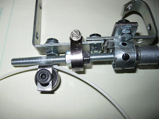

Then came the attachment clamps for the drive screw Drive Bearings 1 and 2. Drive Bearing 1 is held by plumber's tape and a piece of steal and Drive Bearing 2 is held by a pipe clamp. I would only make the plumber's tape ones in the future. It held better.
And that's it, your done!
Keep in mind this is not a finished extruder design but simply a starting point for better designs and more detailed builds. I test this by clamping it to the desk and hooking up the GM3 gear motor. Worked like a champ. Total cost for all parts was something like $20 US. Total time to build once all the holes were drilled and the pieces were bent was about one hour.
Adjustments concerning the height of the 608 bearing form the drive screw--the one that presses the filament into the threads which I call the Pressure Bearing--can be made by "shimming" the 608 bearing held by the pipe clamp--Drive Bearing 2. I did this by inserting small pieces of scrap tin between the frame and Drive Bearing 2 so that it pushed the drive screw incrementally closer to the Pressure Bearing. This works very well and is very quick.
Please, if you have a good idea for improvements, fixes, etc., then please let me know.
