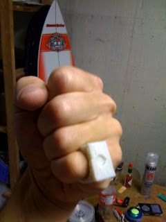

I've had my Darwin close to finished for over a month now, but various software problems have kept me from being able to print until now. I was never able to get the Java host software to work reliably, and due to a slightly off center extruder screw, I decided to try and incorporate Zach's magnetic encoder board. That worked beautifully, but code space limitations meant I had to run the Gcode variant of the firmware (thanks again to Zach!), which required installing and understanding an entire new tool chain, which again took a fair amount of time. It's all good now though!
I had a good laugh on my first minimug attempt though. With great apprehension, I watched the mug take shape, but after the raft was built, the mug looked decidedly triangular, not circular. I almost stopped the print, thinking some joker had switched out the files on the Wiki, when I realized that the minimug.stl file needs to be rotated 90deg about the x axis, otherwise it prints on it's side. Printing a mug on its side definitely does not fit the "no overhangs greater than 45 deg" rule, but it sorta worked anyway. Check it out:
Both mugs are a bit lumpy yet, as my Darwin is a bit loose in most directions - all of my cast bearing inserts are 1 to 2 mm too large, making all the tolerances very loose. Soon I'll print out some new bearing inserts and drill them as close to 8mm as I can, that should sharpen things up a bit.
Finally, a fuzzy cell phone shot - I'm now cranking out RepRap Power Rings, I figure they'll make nice playa gifts next week at Black Rock Desert, a little harbinger of what's to come. :)

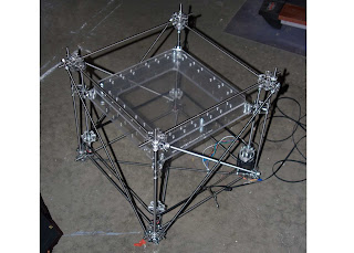

RepStrap Build Using Laser Cut Parts Kit - Update
Here's a picture of the main bot so far:
Things haven't been tightened because I don't have the slide bearings yet and 4 of the side diagonals are missing. I just had to see what it was going to look like.
What went wrong:
1. I broke 2 more of the plastic parts even though I have been extremely careful when tightening bolts.
2. I have not been able to locate a US vendor for slide bearings with the exact specifications as the Skiffy ones from the UK.
3. The side diagonals were short on 2 sides of the main assembly. All of the rods are specified at a length of 600mm and I found that 610mm long rods worked for me for 4 of the rods that make up the 2 side diagonal assemblies. I'd be curious to know if anyone else encounters this. I measured all of the dimensions between rods and I come out with a different diagonal spacing for 2 of the four sides.
4. I've seen the thread on the mechanical forum about splicing the Z belt. It looks like any of the suggestions will work but I'm curious to know what Ian had intended. Hopefully he will add his input to the thread or maybe a procedure on the Bits from Bytes web site. I'm guessing that it's probably the same as for the original Darwin as described by Adrian.
Recommendations:
I wasn't happy with trying to adjust the corner brackets that clamp onto the 8mm smooth rods so I used 2 70mm smooth rods and inserted them in parallel with the rod being clamped onto. Here's a picture:
I then took up the slack on the M3 nuts so that the plastic bracket pieces were parallel. Not too tight because you won't be able to remove the 70mm rods. When all of the nuts are snug, remove the 70mm rods and tighten the nuts about another 1/2 to 1 1/2 turns. Once again, not too tight or the bracket parts may crack.
I hope this explanation makes sense.

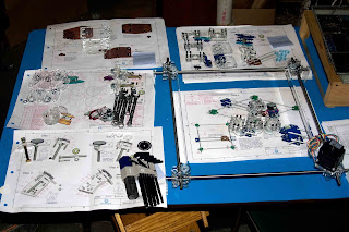

What went right:
1. Parts are very well made. Well done Ian!
2. Drawings were easy to follow and no major assembly problems so far.
3. I have all of the sub assemblies built as far as I can go with the parts that I have.
What went wrong:
1. Some of the M3 and M8 clearance holes in the laser cut parts were very tight. I opened the holes up a tad using a small fine round file.
2. The areas meant to captivate M3 nuts are very tight for nuts measuring 5.4mm in width. I didn't want to force them and possible crack the part so I ended up taking a fine flat file and opening up the cavities ever so slightly.
3. I ordered some of the wrong hardware, M8 bolts not threaded the full length for example.
4. Having trouble locating a few parts such as the sleeve bearings.
5. I had already cut the plain rod lengths from the old Darwin specification and the new lengths are different. Need to order more stock and and re-cut the rods to the new lengths.
Recommendations:
1. Don't throw away anything from the sheet of laser cut parts. I lost one of the smaller parts.
2. Print out the PDF of the parts sheet available on the Bits From Bytes web site and check all of your parts.
2. Take a fine flat file and remove any small bumps on the edges of the laser cut parts.
3. Before assembling any laser cut parts, run the proper bolt through any clearance holes to make sure they fit before trying to assemble them.
4. When you get to the extruder construction don't forget that there are 2 videos that are absolutely essential. One of them locks up and I seem to remember a post on one of the forums about the lock up but I can't seem to find it.
Next:
I already have the electronics built and tested as well as the Java host application up and running using source code in Eclipse. I have built the firmware from source and that's what I'm running in the PICs. I don't have an Arduino yet.
I will have my rods cut this week and order more parts so I should be able to get a lot done next weekend. This is the most fun I've had in a long time.
