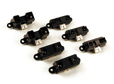

Preliminary measurements on the Sharp IR distance measurement chip
I did a quick lashup for doing some rough measurements with the Shart IR distance measurement instrument I bought.
Here you can see the instrument itself to the left and above the prototype USB controller board. I slapped on a few extra screw terminals to handle the three lines off of the instrument.
I was able to get it to spot a piece of 3 mm HDPE feedstock at 500 mm away. This one has a range of about 1500 mm and a voltage range of 0-2.75v. Given that it costs right at $12.50, that's not bad performance at all. Sharp has another model which is focussed in to 300 mm. That might a nice one to mount on a Reprap to scan an ongoing print job.

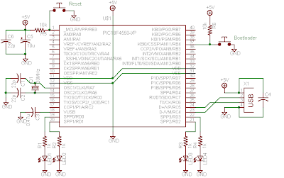

Built PIC USB prototype board
I had all the parts for making my first PIC USB comms board more or less when my son called late Friday afternoon asking if he could come home for the 3 day weekend. Things got a little slowed down for me as a result. :-)
Anyway, my son came for a study weekend. He had a lot of reading to do, so I undertook to try to cobble a prototype board together to get used to USB comms between the PC and the firmware. All I lacked was a 0.47 uF ceramic disk capacitor for the Vusb pin (pin 18) on the 18F4550. I wandered down to Potter's and then Radio Shack looking for such an animal and came home empty handed.
(Read the whole story)

Starting with USB
Well, I have all the parts now to get away from serial comms and over to USB 2.0. Instead of buying a chipset that attaches to my current PIC (this being the mainstream approach, I understand), I'm simply upgrading to a PIC that can handle USB by itself. My firmware compiler will handle that.
I've started with eegeek.net's basic demo board for USB comms and scraped all of their little twinkly LED's off, which leaves me with this very, very basic board.
It also leaves me with 29 usable pins to control Tommelise 2.0

I ordered the parts to make the new USB controller board. The hardest part was finding the USB Type B connector. After getting a look at what they are charging for USB cables I suspect that I'll be making up my own from scratch as well. I'm going to be needing a particularly long one.
I'm trying to get my head around what the firmware for Tommelise 2.0 needs to look like when all the really tough calculations can take place in my PC. The bandwidth on the USB port is going to be several magnitudes larger than the old serial interface, so it looks like the PIC is going to spend most of its time simply shoveling in data in a form more or less ready to use by the SN754410 chips and keeping track of things like the limits detectors. I'm thinking that I might well try to run each of the SN754410 chips with a smaller PIC like the old 16F628A. That would let give me fewer worries about pin counts on the 18F4550. How I put that all on a Euroboard is another issue. I expect that I am going to have to make smaller boards for the individual stepper controllers. Oh well, well see how that works out as I get further into the project.

USB 2.0 on Tommelise 2.0
Once I bit the bullet and decided to go for USB 2.0 comms for Tommelise 2.0 and tentatively chose the 18F4550 as the target PIC chip things started getting very easy. As usual, the PIC data sheet for the 18F4550 was pretty opaque. On the web, however, it turns out that a lot of people have been exploiting the 18F4550 for USB connectivity. I found this link very useful. Not only does it give you a schematic, but it also gives you a full, working set of PC side and PIC side code that makes things work.
As well, they use a bootloader for chip programming. I wonder if my Oshonsoft BASIC hex will be compatable with that?
This is getting to be fun!
