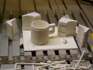

LOM-fabbing with a CNC-repstrap
Hi all,
... i'll post some images of my first LOM-fabbing (LOM=Laminated-Object-Modelling/Manufacturing) with a CNC-repstrap and a minidrill.
As you can see, with this method it's no problem to make overhangs or complex geometries out from single prefabbed sheets:
Here is the reactivated CNC-system:
Outputting a single sheet - the software:
Outputting a single sheet - milling:
I'm waiting to by a 'serious' millhead, then i'll make some 'real' parts needed for going further with my tripod-repstrap and the dispenser-heads.
One of the next goals is a software or conversion for automated slicing the LOM-sheets from a STL-file, so it would be much easier to process ...

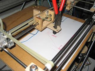

Etch-a-sketch
Thought it was time to put my cartesian contraption to the test. Downloaded the STL files from sourceforge and started plotting (not extruding) the corner bracket.Instead of the extruder, I placed a holder on the carriage for a pen (see image left) and this way it should be possible to plot the lines and see how that goes.
I noticed a few things: first of all, sometimes the carriage moves back to it's home position, for no clear reason. In a way a good thing: this was the exact same point every time, so it is actually pretty accurate (see also the image below where the 4 lines cross)
The second thing I noticed is that my settings are not scaling correctly (the bracket is 44 mm, the plot measures 48) but that should be fairly simple to fix in the Host software settings. I also found that my carriages goes a bit up and down (in the Z direction, which is why the plier is placed on it, to keep the pen down on the paper) and this is due to some slack in the carriage and XY assembly, which could be harder to fix.
The end result, a "plot" of the corner bracket, is shown on the right. All in all, I am a pretty excited! Next step is to get the extruder up and running again, and try some real printing.

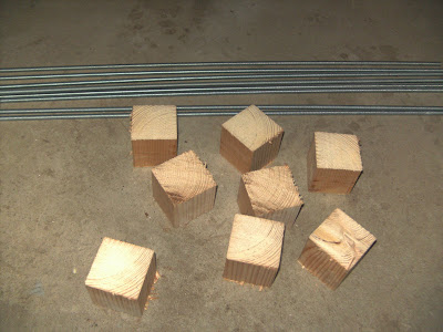

IKEA Modding
In my quest for simplicity I decided to build a RepStrap frame with only this hardware:
I went to the hardware store and bought _all_ the rods they had and some nuts & washers.
Once started, it all seemed fairly easy, except from the clumsy handling with the 100 cm rods that I was afraid to cut too early.
When the frame started to take the shape of a cube there was a frightening amount of wobble.
Then I finally used my swedish "secret weapon" because I was hoping it would make the wobble do away completely - and it did.
That beast is rigid as hell!
- 8mm threaded rod (12x)
- M8 nuts + washers (48x)
- a log of wood
- IKEA Observatör 70x70 cross-brace (5x) (1 £ / 1.90€ each)
