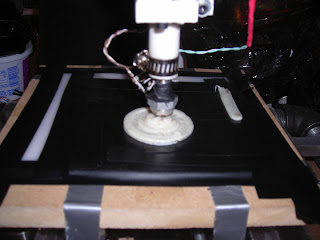

I finally finished my machine and as proof, I have a minimug!
This picture (above) shows the minimug printing the last few layers.

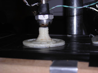

The print is finished here and the machine is going back to it's start position.
As you can see I have something taped to my MDF stage. It's actually a grocery bag (HDPE) and I'm printing in ABS. The black bits are electrical tape. I've since switched to an all electrical tape stage which works a whole lot better. I get really good adhesion from this setup. No problems with objects detaching themselves from the stage mid-build.
There were some alignment issues to deal with. Mainly this was a matter of getting my prefs set right in the host and aligning my head more fully with the stage. Can't have one side higher than the other. I fiddled some more with that and called it good.

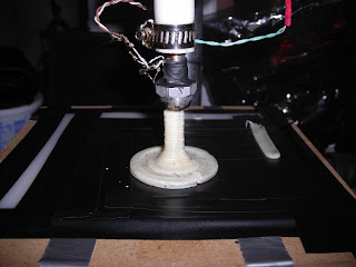

Upon successful first printing--and after the minor celebration that ensued which only involved me and my friend Noah--we immediately started looking for other things to print. Well, Vik's wine glass looked nice and friendly so we gave that a go.

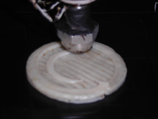

Minimug for size comparison for those of you who have printed a minimug.
Things were going well up until this last photo at which point we started noticing that the extruder wasn't extruding. We had lost pump preasure due to the bolts loosening--I never installed lock nuts on my pump body, stupid. We frantically fixed this while the machine continued to print and got it back on track...sort of. We were left with a ring about a half cm high of less than bonded material. No problem. The shape is still there and we continued to the end.
Sorry that's sideways. Couldn't figure out how to rotate it in Blogger. Feh... Anyways, the form came out great and I'm really happy with how the machine performed. I used a 1 mm extrusion tip on all of these prints. My longest build time was 1 hour, 20 minutes for the wine glass and 30 minutes for the minimug. I've subsequently printed several failed minimugs--one successful one too!--and another failed wine glass.
