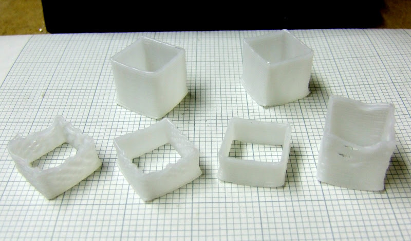

The long and the short and the tall
I have been experimenting extruding different aspect ratio shapes with HDPE :-
Hopefully you should be able to see a general improvement from left to right. My conclusion is that HDPE is not really suitable for extruded layered manufacture because of its high melting point and mold shrinkage.
More details in my blog: scaling-new-heights
Labels: HDPE
