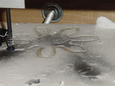

Gears are going to be possible
Just got through with my first 7-toothed gear perimeter. The print layer has bad settings for height and flow rate, but it's pretty obvious that the work I put in on improving the positioning system, never mind making a new extruder barrel is paying off. The teeth on the gear all look the same regardless of their location on the gear perimeter. I made them really big so that I could be sure and not fool
A lot of the problems are coming from the routine that I use to generate the perimeter. It does the teeth twice at the same level for each layer. I've got to fix that.

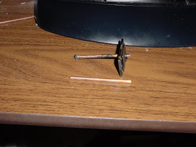

This morning just after midnight I woke up and had a "left the faucet running" moment, viz, had I put the support plate on my new extruder barrel before I braised the copper PTFE flange onto it. I decided that I really didn't want to know right then and if I got up and looked at it I'd be tempted to try to fix it. I'm not that wonderful at midnight work sessions.
This morning, I got up and sure enough I'd left the brass support plate off.
I used the recycled copper PTFE plate this time to cut down on the amount of sawing I'd have to do. Having had a trial run at it last night I avoided some of the mistakes I'd made then and got the whole thing done, with the 0.5 mm hole drilled too, in about 5 minutes. I wasn't hurrying, either.
Here it is.
