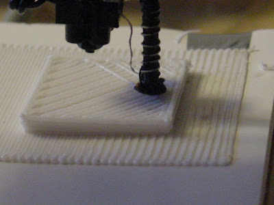

Twenty layers
As I expected, there were no problems in printing 20 layers of the 40x40 mm square prism.
Brief statistics; 40x40x11 mm prism, 50% infill, 3.25 hours print time including 70x70 mm raft, 11.5 cm^3 of HDPE printed with an average extruder head transition speed of 2.2 mm/sec.
I think that I can go on to printing useful things now.

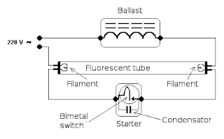

Suntanning blotches... in an Amsterdam summer day??
I have received my UV fluorescent, a Cleo Compact of 15W. It cost me 6€ and is very easy to get in any illumination ware store. The tube allows for a fairly compact mount, as it is only 30cm long (about a foot). They didn't have the mount there for it so i bought the parts and made it myself out of this simple diagram i got from the Wikipedia.
I used a reflectant non conductive mylar plastic strip from a candy bar (Twix, to name it), to use as a reflector. The end result looks like this (left).The bad news is that the spectrum of this lamp is adjusted to mimic the natural solar spectrum of an Amsterdam July day at noon! I'm not kidding!! I was hoping for an ozone-depleted, antarctic, January at noon spectrum! :)
The result is that after my first test-run i had not enough UV-power at the desired wavelengths to get a quick polymerization. It took 2-3 hours to get the resin to set and probably another hour or two to get it to harden... far to long! I will be ordering a black light tube (Philips TLK 40W/10R or F40BL 40W) which have an emission peak at 365nm, exactly what i need for Mechlers Ketone. They deliver 7.4 and 9W of UV radiation each, which is a lot better than the Cleo tube and the price is very similar, although the tubes are twice as big. If the results keep being to poor, I will be aiming for the 100W bulb range, which will certainly do the job, but at a higher price. I will also buy a germicidal UV fluo (philips TUV25T8), which works at the wavelength of Benzophenone.
One last thing slowing down the setting is an effect called Oxygen scavenging. It results through the effect of air Oxygen on the surface, which destroys the radicals formed by the UV radiation inside the resin mix and that are responsible for its polymerization. This causes the surface of the resin deposit to remain liquid while the interior continues curing. There are two ways to solve this problem:
1) Augmenting the photoinitiator of the mix (from 2-3 weight % to 6-10 w%)
this solution is simple but on the expensive side.
2) Adding 2-3 w% of an Amine such as N-Methyldiethanolamine, wich costs around 25€ per kilogram and is a cheap additive and which will react with the solved oxygen in the resin, preventing the radicals scavenging.
One thing i thought of too is to let some resin blotches lie in the Sun (Barcelona Sun, not Amsterdam!). And it did work! I got some slow polymerization on, and i suppose that in 12h exposure the resin would set as well.
One last important effect and that will have great implications for the deposition process. The resin remains tacky and sticky right until the end of the curing process. By timing the UV-exposure and the Amine content correctly, we could achieve seamless interlayer adhesion, almost as if the object had been cast in one piece!
