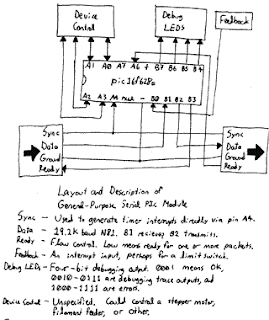

Biollante Boards and Firmware
On the right you will see the basic design I am using for all my modules except the comm controller. I broke my promise to use two-conductor phone cable to join the modules in their ring, but only a little; I now use four-conductor phone cable!
After a lot of cleaning up, I have also made version 0.1 of the firmware available on my site. It includes code for the stepper controller and comm controller, and hopefully a useful amount of documentation with them; they are licensed under the GNU GPL.

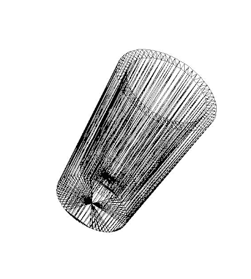

Slice and Dice operational
After a few hours of code cleaning that improved execution speed by a magnitude, last night I ran several full-bore tests of the Slice and Dice routine for Tommelise. The tests created full .tml files for use with the Tommelise Control Panel that drives Tommelise from a Wintel PC.
The tests used .stl files of the gearmotor coupling and the polymer pump taken from the Art of Illusion 3D design specification for the RepRap Thermoplast Extruder Mk2 Thermoplast Extruder.
The .tml file for the gearmotor coupling was about .75 megabytes while the polymer pump's .tml file weighed in at 3.4 megabytes.
The next task is to upgrade Tommelise's Control Panel to read a .tml file and create timed control commands to the 3D printer enabling it to create that object. Since the Control Panel already has a full set of tested commands running the 3D printer this task is not seen to be a major one.
