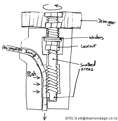

Tidying up the Mk 2.1
The Mk 2.1 seems to be a very different beast from the Mk 2. Yesterday before I got things working properly with the Mk 2.1, Vik mentioned that he often put a clamp on his Mk 2 for a bit of extra pressure on the polymer pump. I grabbed a c-clamp and tried that, applying just enough pressure to stall the GM3 (I don't worry about damage in that it has an internal slip-clutch) and then backed off a touch.
That's when the Mk 2.1 started pumping like crazy. I had the GM3 seated on #40 studding bolts not locked down. I noticed that the motor coupling was riding up pushing the GM3 up on its studding bolts. That didn't hurt anything and I've had the motor coupling, made of a cut coupling nut and nut with a lock washer between the two, come loose before, so I didn't worry too much about it. After I finished running the 400 mm of HDPE, I had a rush of good sense to the brain and decided to take the Mk 2.1 polymer pump apart before I tried running HPP.
That was rare good sense. When I disassembled it I discovered that the motor coupling hadn't broken loose at all. Instead, the thrust collar that I'd made of two nuts with a lock washer between had broken loose letting the whole threaded polymer pump try to work its way out of the pump.
One thing wants noting at this point. I use a thrust collar to absorb the tendency of the threaded drive rod to try to come out of the pump rather than the two bushings that the Mk 2 has. I have the a brass plate with a hole through it to admit the threaded rod at the top of the pump before you get to the motor coupling. The previously mentioned thrust collar butts against that. Basically, I used the same idea that Vik did with his drawing that is in the Mk 2 documentation on the reprap site.
Where the bottom bushing is in the Mk 2 I have a steel bushing that is the same diameter as the threaded thrust rod. This lets me avoid having to mill down the thrust rod since it seats right against the threads.
Back to the story. The threaded rod's thrust collar had come undone and let the threaded rod ride up in the pump till the bottom of the rod had slipped completely off of the bottom bushing.
That's when the pump started working properly.
What that meant was that with the configuration I was using all the bottom pressure springs in the polymer pump were doing was adding friction to the device for no good reason. The springs at the top where I was applying a touch of extra pressure with the c-clamp were effectively the only ones that mattered.
For the HPP I reseated the threaded rod in the polymer pump, really tightened the thrust collar and applied a bit of pressure to the top of the pump with the c-clamp in addition to what the springs could offer.
HPP pumped just fine with this arrangement.

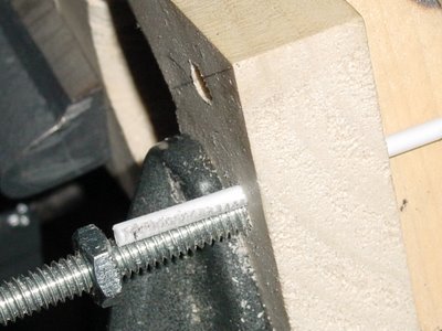

This morning I sloped down to the hardware store and bought a more powerful pair of springs for the top of the pump in the hope that I could get rid of the c-clamp. That worked. You can see the Mk 2.1 sans c-clamp operating this morning in this pic.
The picture shows you something else interesting that is happening. The BBQ paint that I used to tack down the insulated nichrome 80 heating wire is perishing at the top of the heater coil. This lets it delaminate from the extruder barrel and then causes the insulation to overheat and begin to perish as well. The extruder barrel is still working, but I can see how this is going to go.
My first try at a fix for this problem is to use more BBQ paint coats to tack down the heater coil. I've got some other options if that doesn't work.

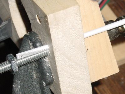

Bloody HPP and HDPE extruded thread everywhere
I've got both HPP and HDPE extruding out of the Mk 2.1 extruder at production rates (~3.4 mm/sec currently).
I ran 500 mm of 2.9 mm HDPE filament and 750 mm of 2.9 mm HPP filament. Now I've got to tidy up the Mk 2.1 so that I can mount it on Tommelise's xz positioning table and then I can begin the long, painful process of getting it to make something useful.

First I did a series of tests with HDPE. It's a fairly tough, but soft surfaced engineering plastic. With hand feed experiments that I did a while back it was slippery to a point where I had to grip it with pliers to feed it into the extruder barrel.
My first instinct was to really tighten the springs that press the filament into the threaded polymer pump. You can do that, but if you try to make the pump run too fast, that is, develop some pressure in the extruder barrel, it just excavates a groove in the side of the filament and you get nowhere. That was discouraging.
I then shifted over to polypropylene (HPP). It is a harder surfaced plastic and the threaded pump drive engaged it much better than it did the HDPE. After faffing around with HPP for a while I began to plan an experimentation campaign.
Right now I'm running the polymer pump with HDPE at 2 rpm and 2 amps power. I'm going to keep power constant and run the rpm up step by step and see what happens.

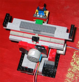

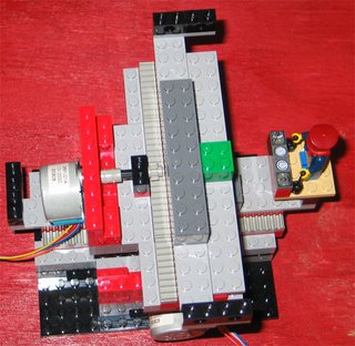

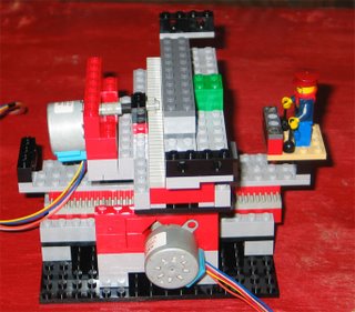

After a series of setbacks... (no video software, my camera finally needed that tape cleaner that's been tucked away in the box for 3 years, and then the wrong software/codecs...)
I had to glue down a guide piece; one of the axles still isn't quite straight (but the wobble has transfered to the now only partially attached motor... not sure how/if I'll reattach that, but it's secured on one of the two motor tabs, and it seems to be holding... It worked itself loose after I glued the guide piece down, and that tab slowly moves 'towards/away' a mm or two. This is the 'upper' axis, moving perpendicular to the camera.) My biggest problem with these is just getting a good connection between the motor and the axle... I'm using some Lego Bricks to do it, so they're true to the axle itself, but the motor itself had to be ground a little to fit, and it's not quite solid...)
The Z axis just plain didn't work... It's gone back to the drawing board, but maybe I'll have better luck with the actual pieces in front of me. The issue was that the axle wasn't 'solid' enough, and over the inch and a half or so that it spanned, it had enough give to move away from the rack pieces... I'm trying to come up with a better design; maybe with a guide block on either side of the rack piece to help hold the axle tight against it...
The only major hurtle I have left is figuring out how to get the two little controls on the operator's workstation to move in sync with the axis :)

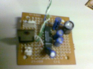

Upgrading the Mk 2.1 test board...
My jaw has recovered sufficiently from the bone graft so that I felt inclined to do a little light soldering this evening. I decided to add a dual Darlington 754410 chip to the Mk 2.1 test board in order to allow the testing of the polymer pump gearmotor and the heated extruder barrel as an ensemble rather than trying to get the whole thing to work off of the main board along with all the software that I already have working there. It seemed simpler.
I've set the board up to feed 12v power into the gearmotor instead of 6v. That will make it run faster, but I will also get a lot more torque using the 12v Solarbotics motors and the use of shaft encoder monitored pseudostepping will let me run the motor at extremely low speeds will full torque.

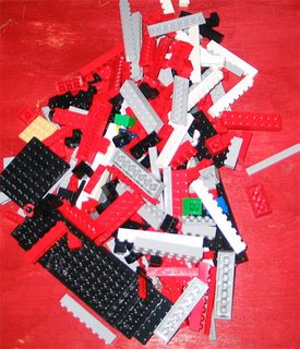

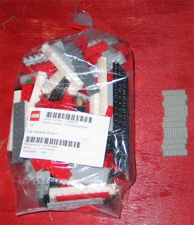

The Lego Bricks have arrived! (apparently they're not Legos... they're Lego Bricks!)
I was hoping for a compartmentalized box, with the pieces randomly segregated into their own little packages; I didn't even get any Lego bags!
Still, it was just that much quicker before they pile had formed!
And the XY axis was quick to follow! I did most of this by memory/picture, and had it together in 10 minutes. I'd already prepped the motors while waiting for the shipment to arrive so they just popped right on.
I've already found a weakness in this design; the black 1x2 that the axle goes through, along with the two 1x2 red flats below it, can work loose and derail the pinion gear. I've tried to push it down as hard as I can, and it seems to hold, but I suspect it needs to be glued or something to ensure it doesn't pop off during use.
A little electrical tape securely holds it on for the time being. I'll replace it with hot glue once I'm ready to secure it all down. I used hot glue on my prototype and it worked perfectly; it also comes off cleanly with a fair amount of prying.
Aside from the guide brick coming loose, the XY axis moves back and forth nice and smooth. Once I decide how I'm attaching the limiter switches (and decide which of the two I've got to use), and glue stuff down, these axis should be done!
While the XY axis went together easily, the Z axis was a bit more of a problem. I decided it was too tall, with too much wobble potential, so I moved it below the XY axis, instead of on top.
The general setup and idea still seems sound, but there was a flaw in the design, well two. They all center around the rack gearing that runs down the inside of the inner piece. The motor mounts on the outside frame, through a guide, and meshes with the rack on the inner frame, pushing it up and down. I made some miscalculations on how the transition pieces (black pieces on the inside, with the nubs sticking towards the center) line up with the bottom of the white piece (the one with the rack attached to it). I did a little rearranging and was able to get the pieces to line up, but I only used two of the four transition pieces. In addition to that, the white piece is too thick and sticks the rack out beyond where the pinion gear sits. I'll need to use some flat pieces to line them up if I want more than two.

Vik's polymer pump configuration works...
I found a piece of 1 x 1/4 inch steel bar and drilled a 1/4 inch hole through it. I then made a thrust collar out of two 1/4 nuts and a lock washer. An assembly of scraps from a z-axis thrust collar from the defunct Godzilla RepRap prototype served as an adequate mount for the bar and I was able to shift the torque application from the output side of the polymer pump lashup to the feed side.
I again used pliers to rotate the threaded rod. This configuration seems to require less torque that the previous experiment.
I am observing the tendency of this polymer pump to slowly rotate the 3 mm filament. It appears to complete a rotation every 1-1/2 inches. This is the same slippage that Vik Olivier has documented with his Mk II.
Most of the energy used in this pump seems to be employed cutting the threads into the filament. I tried to attach my electric screwdriver to the threaded rod with little success. My electric drill, on the other hand, proved far more of a success. Here you can see polypropylene filament being pumped. Please pardon the blurriness. I had to operate the drill with my right hand and the digital camera with my left. Sadly, my son has gone off to university again, so I'm down to two hands again.

Here you can see my dumb little experiment. I took two scraps of 3/4 inch poplar. I drilled slightly overlapping 3 mm and 1/4 inch holes in one of them. The 3 mm hole is for the filament and the 1/4 hole is for the threaded drive. The second piece of poplar scrap covers part of the 1/4 inch hole so that the threaded rod actually pumps the 3 mm filament instead of just crawling out of the other side of the board.
Seating the 1/4 inch threaded rod and threading in the 3 mm polypropylene I rotated the threaded rod with a pair of pliers.
As you can see in this closeup the threaded rod bit into the filament and pumped it right through the poplar board.
Keep in mind that I am applying torque to the rod from the bottom of the metaphorical polymer pump instead of the top, so the second scrap of poplar absorbs the thrust at the top of the pump. I will need to apply torque to the 1/4 threaded rod at the top so I will have to adopt a scheme somewhat like Vik did in his drawing where he used a lock nut seated against a thrust collar at the top of his pump. Doing that there should be no need for any machining of the bottom of the threaded rod. It can simply seat against the 1/8 inch brass or aluminum plate that I will have between the poplar pump and the PTFE thermal barrier.
There you have it. No springs holding two halves of the pump together. No machining of the threaded rod. I might use a file to make some flats on the rod where it meets the gearmotor. I'll probably use some fish tank tubing to connect the gearmotor and the threaded rod, though I might simply cook up one of those coupling nut connectors that I documented some time ago.
It might not work, but it won't hurt to give it a try.

Howdy all. I'm Buzz.
Over the last few days I've read very intently pretty much every single page in the reprap wiki, most of them more than once... and I decided to start building a reprap/strap. I'd like to blog the build process for the benefit of others! I started 3 days ago, and I now have: * the "stripboard" comms controller fully working* my first (X) axis unipolar stepper controller built and working (buggy, but the stepper turns some of the time!) - also made as a "stripboard version".* all my stepper motors, and about a dozen spares of assorted sizes(been collecting them for a while)* a lot of old printer hardware (rails, belts, etc) that has been stripped down in preparation for "the build".* all the software installed and running in an existing linux server I also use for my http://www.mythtv.org/ tv server.
Here's a few pics:
(small square board is my max232 based comms board)
(retangular board is the X -axis stepper board)
(a pic of the two of them wired to a small stepper)
(some of my gutted printer rails with beefy steppers - I have 3 of these!, two shown)

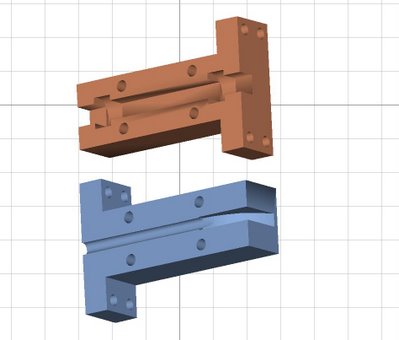

I completed the design for the overall interface of the new, low inertia extruder barrel with the Mk II polymer pump.
It works rather well, I think.
I've basically thrown away Adrian's ABS bottom plate, which he calls the "Clamp" because it clamps onto the PTFE rod that provides the thermal barrier between the heated extrusion barrel and the ABS body of the polymer pump of the Mk II.
I've replaced the "Clamp" with the new extruder barrel which is fabricated out of 5/32 inch hard brass tubing and braised onto a 25x40 mm support plate (all in yellow). A 25x25x40 block of PTFE (pink) fits over that and is backed with another 25x40 mm support plate (also in yellow) that bolts directly onto the bottom of the Mk II polymer pump using the existing mounting holes.
This reduces the width of the overall Mk II assembly from 76 mm to 40 mm. That should, if I want, mount two of them side-by-side on the xz vertical positioning plane on Tommelise.
