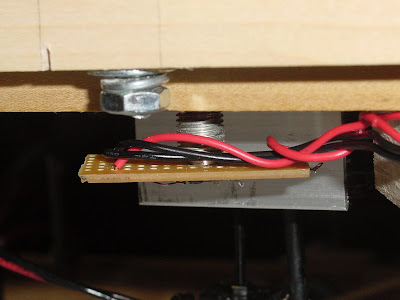

The AS50305 chip that does shaft encoding for the z-axis is in a very awkward location. The little board that holds it comes out of alignment quite easily and when it does I lose z-axis control of Tommelise's positioning system. When I was tapping the z-axis controller once per layer this was no big deal. Now, however, I have to use the z-axis every time I jump from one line segment to another.
As you can see it is under the x-axis gantry and behind the xz positioning plane. That means that if it gets out of alignment you're working with a flashlight and your fingertips and praying that you don't pull one of those fine little filaments that connects the AS5035 to the stripboard fragment that it's mounted on.
