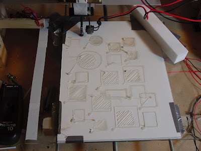

I haven't been publishing much this last week, mostly because I've been fighting with the Tommelise firmware to make it do what I want it to do. I've done a lot of hot extruder tests, as you can clearly see.
I've been primarily working on the perimeter/cross-hatching infill misfit problem for the past few days as I'd mentioned earlier. I seem to have cracked that one for now so now I'm going on to get a degree of control over the extrusion rate. As you can see at the top of the foamboard I was running some of the extrusion exercises both too hot and with the extruder head far too close to the board. I'll be working with those parameters and with trying multiple layers over the next few days.
