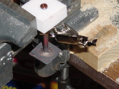

Because of that I decided to braize a piece of 0.635 mm copper over the end of the 5/32 inch copper barrel. Some of the advantages of American mix and match standards is that a 5/32 inch hard copper tube just about exactly seats a 3 mm plastic filament. That really cuts down the metal mass in the extruder barrel.
I'd planned to learn braising for some time. This morning after reading up on how it's done I got a propane torch, some copper/phosphorus braising rods and a bbq lighter. The braising rods were rated at 40,000 psi so I figure they ought to handle whatever I throw at them in terms of pressure. Interestingly, I'd read that I needed to use flux, but when I bought the rods the instructions said that flux wasn't necessary. It wasn't, either.
Here you can see the 0.635 mm copper end plate with braising flange lying beside the 3/16 inch hard copper tubing.
Here you can see a piece of copper/phosphorus braising rod wrapped around the join between the end plate and the tube. Note that I use larger alligator clamps to hold things together. That works rather well. As an aside note that the copper/phosphorus rod is rather brittle. You have to be careful when you bend it around tight corners.
Here the tube is set in my vise and ready to heat.
Now I begin to apply heat to the join.
I faffed around for a while with the torch running at too low a flow rate. When I cranked it up the braising rod immediately melted and connected the join with no trouble.
Another pic of the braised join.
Here I've sawed off the support flange.
Here I've cleaned off the oxide from the braised end cap and knocked off the rough edges. It now looks exactly like a hollow copper nail.

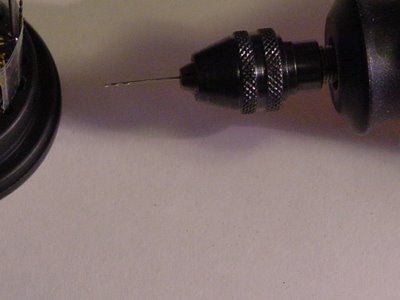

Here is the Demel set up with a #76 wire gauge drill. It's right at 0.5 mm.
Here is my extruder barrel after drilled the extrusion orifice and cleaned it up a bit more. The orifice is there, but too small to photograph well. I put a drop of coolant on the end of the extruder before I drilled. I had drilled a test hole before through that thickness of copper without incident. This time, however, the drill bit binded when it went through the copper end piece and snapped. While I was doing this by hand I don't know that it wouldn't have happened in a drill press just as easily.
Adrian, Simon and Vik, you've done this before. What am I missing in the drilling technique. I stayed extremely steady and very, very light on the pressure on the bit. Indeed, I wasn't even letting a very small fraction of the weight of the Dremel onto the bit. Suggestions?
In any case, I now have a braised, low thermal intertia extruder barrel with a 0.5 mm orifice. If I can sort out the drill bit breakage problem this could be a nice way for people without lathes to DIY this fiddly bit of the Mk II.

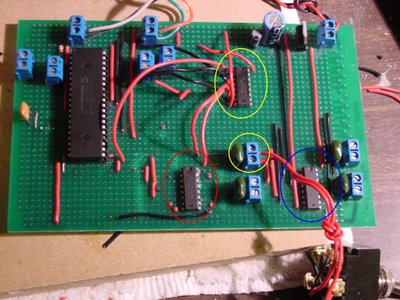

Z-axis enabled on the controller board...
I tried installing a second 754410 dual darlington chip to power the z-axis gearmotor. What a mess!
First, I installed a 754410 for the z-axis and the Mk II (circled in red) to the left of the one driving the x and y axes (circled in blue). Trying to be neat I managed to miswire the new chip to the point of creating a short within the chip.
I started to dig it out of the board (you can see the cut pins on the right side of the chip) and then realised that I had some spare space on the board. I put a third 754410 (circled in yellow) in and did a quick lashup of the wiring which is very easy to see. You can also see the two terminal connector that runs the z-axis (circled in yellow as well) That mare's nest worked first time out. There's a lesson in there somewhere, I expect.
I tested out the wiring with the {HZ+} and {CZ+} commands and it worked perfectly.
The limits detector went together fairly smoothly and the firmware for managing the x and y axes checks out for the z-axis as well. The {RZ} command now works.
Now I have to wire up another shaft encoder and the z-axis will be good to go.

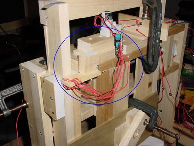

Running x and y axes as an ensemble...
I've got the x and y axis gearmotors working as an ensemble controlled from the same 18F4610 microcontroller. The bigger, faster PIC chip let me program in some monitoring of performance and statistics generation.
I ran the ensemble in two initial modes for a 2:1 slope; the first using 100 msec motor pulses and the second using 10 msec motor pulses.
For 100 msec pulses.
For 10 msec pulses
I think a big chunk of imponderables, to use Adrian's word, about using gearmotors with shaft encoders are no longer imponderable.
I think the only real imponderable left for RepRap developers as opposed to builders is whether SDCC can be talked into creating good hex files for the 18F family of PIC chips. My own experience with 16F PIC's is that they haven't got the muscle to be used in a single board controller for a reprap. I really tried to make it happen. Perhaps some really good code god could do it, but not this lowly wallah.

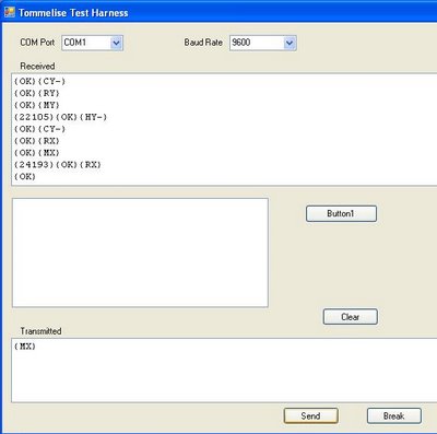

Running Tommelise from the PC...
The serial commands that I programmed into the PIC 16F877A are finally beginning to firm up. Sending from the PC:
{RX} - reset the axis
{RZ}
{MX} - measure the axis in pulses
{MZ}
{HX+} - move in the +x direction on the x-axis
{HX-} - move in the -x direction on the x-axis
{CX+} - stop moving on the x-axis
and so on...
Here is a screen grab of the test harness that feeds instructions to the 16F877A via the serial link...
As you can see when you tell it to, for example, measure the x-axis {MX}, the firmware returns the number of encoder pulses counted as the x-axis moves from the beginning limit to the end limit. After any process is finished the firmware transmits a "finished" {OK} string.
You will notice that the pulse measurements for the same axis are similar, but not identical. Right now, I carefully line up the axis at the beginning limit but only stop measuring when the gearmotor hits the other limit at full speed. It may make a revolution or two running at full speed before noticing that it has been turned off. This isn't too important in that I only need an approximate length of the axis plus a replicable starting point. I've got that.

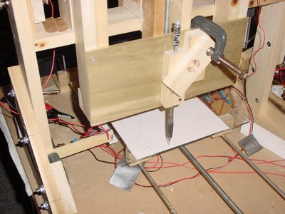

Pencil holder assembly...
Thanks to a timely pointer from Adrian about weighting instead of spring mounting my mechanical pencil I now have an operational pencil tracing device.
Now to set up some formal grid tests so that I can get an idea of just how repeatable my cartesian positioning system is. I've already detected what appears to be non-isotropic behaviour of the gearboxes with respect to rotational direction. It's not a big difference with you can see it now and thanks to Adrian I know it's not some duct tape artifact. :-D
