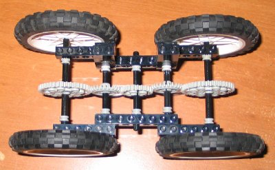

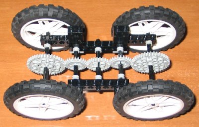

This is the beginings of the X axis; a 4 wheel drive, no steering, carrage. I'm hopeful that the traction between the wheels and the carpet will be enough to maintain enough accuracy over the duration of a single print job. If not, I may move to the threaded rod driven technique I build into the Z axis. (I haven't secured everything here; I'm waiting to figure out how I'm attaching the Y axis to this before I worry about how much more 'support' I need to put into it. It'll also help to know the correct spacing between either side.)
You can see here where I started to build up the support for the motor; the two towers of black bricks in the center back. The motor will drive the center gear, which will transfer motion to the mid gears, and onto the wheel axels themselves. Everything is symetrical and matches end-to-end, so I'm hopefuly to get solid, flawless 4-wheel drive. I'll be mounting the Y axis above this, but I'm waiting to mount the motor before I work on that. (I've had a bit of trouble glueing legos to metal gear on my steppers, right now I'm trying something called E6000 and I'm giving it the full 72 hour cure time, and I'm only 12 hours into it!) I'm only glueing the grey 1x1 rounded socketed piece to the motor, so I can change not only the gear on it, but also the length of the shaft. I'm currently trying to use a gear the same size as the middle three in the carrage itself.

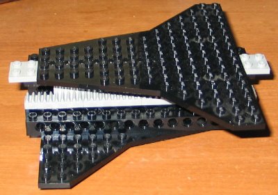

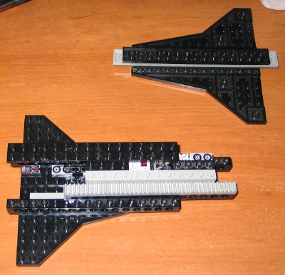

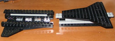

Here we have the Y axis. You'll notice the familiar 'fighter/spaceship' style flat pieces from the original Lego axis; they're the only decently sized flat pieces I've got! You can also see here the rack for the rack & pinion; I'm going to be using the smallest 1x1 gear I've got for the pinion; I figure I'll be getting enough speed just by moving to rack & pinion, I want to maintain some accuracy so I'll go with the slowest, most accurate rack & pinion I can make. The rack is actually attached to the top half of the axis, so I'll be mounting the motor onto the flat 'wing' in the lower left of the picture.
Here you can see the two halves of the axis seperated. You can see the smooth-flat pieces in the center of the bottom that I used to allow the smooth movement; I didn't have enough for full coverage, so I spaced out pieces along the outer edges (it's a 4x14 area) to distribure the weight as best I could. The 'floating flat 2x16' in the upper left of the picture is used to hold the top half of the axis down; riding on another line of 1x smooth-flat pieces.

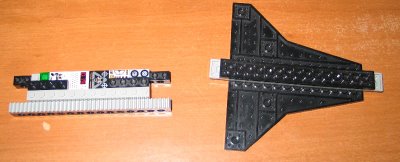

Here you can see the top half of the axis taken apart. To the right, the flat platform that will eventually hold the work surface. On the left sits the carrage that handles the movement. You can see the rack on one side (for the rack & pinion), and the smooth-flat pieces on the other side (for the 'floating flat 2x16' to ride on). (The 2x2 smooth-flat pieces are not 'critical', I simply ran out of 1x2's and had to improvise...)
One trick here, I've got four 1x pieces side by side, all connected; but no 2x pieces in any of it (excluding the non-important 2x2 smooth-flat pieces). The secret is in the foundation; four technic 1x pieces, side by side, attached with the small 1x2 round pieces... (not the straight up + axis, but the round pieces that 'plug' into the technic hole). I've got two of the round connectors connecting each pair; 5th hole in from either end on the outer pairs, 6th hole in from either end on the inner pair. I found those to be a lot more secure & true than relying on 2x's or flat pieces, and being internal, they didn't effect the 'footprint' of the part they were strengthening.
The bottom consists of the 'frame' (two 1x16 pieces on the outside), the smooth-flat pieces for the carrage (I would have liked to have more in there, but I don't think you want to cover the entire surface; it's the old friction vs stability game...) and the 'floating flat 2x16'.
Here you can see the carrage inside the bottom of the axis. I actually got this 'action shot' backwards; if the carrage ever goes that far in that direction, it'll have driven off the end of the pinion gear! I'm placing the motor off to one side, rather than the center, for weight/stability reasions, though I'm not sure yet how far off to the side it will be.

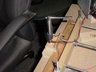

I'm getting ready to mount a second 754410 onto my 16F877A motherboard in order to try to accomodate the z-axis pseudostepper motor and the Mk II extruder polymer pump. Before buckling down to do that, though, I just swapped over the circuitry for the x-axis to test the motor mount for the z-axis.

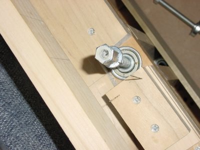

I finally got around to mounting those guide tabs after mounting the GM8 gearmotor. They smoothed out the movement of the x-axis rather dramatically. Feeling ambitious I decided to see if I could get a thrust collar built for the z-axis positioning stage as well. The threaded drive rod for the z-axis is quite short. As a result I decided to see if I could get by without the sliding joint that have proved necessary in the y and x-axes.

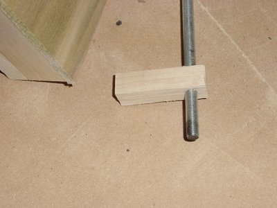

While I had a coupling bolt I thought it might be nice to see if I could make a thrust collar out of something else. I first thought to simply make one out of a blob of CAPA in the manner of Vik. After a while, however, I realised that I had a drill and tap for 3/8-24 studding, so I decided to see if I could make one out of poplar.
In fact, I could. The poplar thrust collar was quite a nice fit and had no backlash whatsoever. I then began working out the excess friction out of the collar with the GM8.

Here you see some of the bits come together in situ on the x-axis platform. I'll probably have to rebuild it again after I get this try at it put together. I was originally going to use 1/4" steel guide rods like Cat did, but changed my mind after I got acquainted with how easy that arrangement jams if it is the slightest bit out of alignment.
Here is the full z-axis stage without the carriage for the extruders in place. As designed this one can accomodate two Mk II sized extruders grouped in towards the threaded thrust rod in the centre with their electronics cards mounted near the outer edge. This ensemble looks big and bulky. It is bulky, to be certain, but surprisingly light at about 750 grammes. It is also quite stable.
I haven't mounted all of the guide tabs and it tends to try to rotate about the y-axis about half a degree while doing an x-axis traverse. The guide tabs should cure that. I was able to stabilise it by putting one fingertip where one of the tabs will go.

It uses a pair of metal rods for supports (salvaged mine from a CD/DVD stand, and they're not that strong or straight, but they're good enough) and a threaded rod for movement (with a drive nut in the center support). This is done both horizontally for the X axis, and vertically for the Z axis, sharing the same center (wooden) piece. The end pieces are all identical, a 1x2 (cherry I believe) cut to size (about 6 inches), with 3 holes drilled through them. I used a little plastic hand held Dowel Jig to drill the holes, and while they were all straight and consistant, they are all, consistantly, a few degrees off perpendicular. This probably would work better had I used a friend's drillpress, but not everyone has a drill press (and I'm not patient enough to wait for people to wake up so I can borrow their power tools!).
The motors (one per axis) are mounted to one end of the axis, attached to the (wooden) support on that end. I used some long screws and two pair of small wooden thread spools to hold it away from the support (to give room for my messy attempt at a connector between the motor and the threaded rod). Using a dremel(ripoff, with authentic dremel cutoff wheels), I shaped one end of the threaded rod to get a better grip with the connection, then used a bunch of electrical tape to tape it to the motor. It's not perfect, and the X axis has been giving me trouble with the tape slipping and the threaded rod 'seperating' from the motor, but it'll get me by for the time being.
The center support is where all the 'magic' happens; it's got both drive nuts for the X and Z axises, and it's the most complex piece in the while thing! I basically took a piece of 1x2, cut it longer (8 inches I believe), and drilled extra holes in it. The same three for the X axis (same spacing as the 6" pieces, lined up to one side) , and then an additional three for the Z axis, drilled perpendicular to the first three holes, with the same spacing, but lined up to the other side. (The six holes end up generally evenly spaced, criss crossing in a perpendicular pattern.) I then drilled out a pair of slots (one for each axis) to slip the drive nut in; they're not perfect, but they hold the nut snug enough that there isn't any play and I didn't have to glue them or anything. I slipped an extra 1x2 piece (cut to 6" with the same hole layout as the 6" pieces) over the Z axis ontop of the center piece, and attached it with glue; this gives better stability to the Z axis and helps to compensate for some of the wobble brought about by the oversized holes.
The limitor switches are taped to the four outer (wood) support pieces, and are triggered by the center piece. (I actually taped a yellow flat 2x4 piece to the center piece to help trop the switch on the top of the Z axis.) This whole contraption is mounted to the speakers through the two end pieces of the X axis, with a single screw through each. I've got them sitting ontop of some scrap 1x (from earlier attempts), to give enough clearance for the motor (with a diameter larger than the 1" thickness of the support).
There's a little bit of wobble, but I'm not still not too concerned about it. I've got a lot of imperfections in the system (as per my design), and I plan to start trying to extrude replacement parts before I worry about any of if; The wobble is reduced considerably as the speed is reduced, and if reprapping a more accurate reprap just means spending lots of time at it, that's fine with me... Once I get an extruder head, it'll be attached to the (wooden) support at the bottom of the Z axis. I'm not too worried about the axis being able to support it, it still moves pretty smoothly at 'full speed', and being the Z axis, it won't need that speed during use.

I've built the (Lego) supports for the Lego Axis, and mounted them to a board. I mounted the motor to the front support with Legos and hot glue, and then attached pair of limiter switches to either end. I used electrical tape to tape down a set of '1x flat' legos to the board, and then just stacked the rest of the bricks ontop of that.
To get enough movement out of it, I had to raise the 'platform' so it would clear the support on the far end. The motor/wires/etc are too much of a liability on the near end, so I built the (grey) limiter stop out on the end; the far side uses the (black) support piece as the limiter stop. The switches are the black plastic pieces on either end (in the top black Technic piece on the near end, the top red Technic piece on the far end) with the 'metal tab' coming out of them. The connectors on the limiter switches are spaced just right to fit perfectly into three technic holes (using the first and third for the ground and 'usualy closed' leads)
Here are pictures of the motor mount, made out of legos. I just extended out from the near support and built up some blocks.
I then hotglued the motor to the legos (didn't feel like trying to drill into my legos, and the hot glue seems to work just fine!)
There's still a little wobble, but it's reduced quite a bit, and the wobble is actually more in the supports/motor than the carrage itself. I also know I'll be able to reduce a lot of that wobble once I get a decent connection between the motor and the threaded rod! (currently just electrical tape that mostly holds in a generally straight manor... hot glue didn't work and I haven't gotten around to getting any CAPA or anything else)

To get the chip onto the RepRap y-axis I did a quick lashup onto a thin wafer of poplar and attached it to the z-axis frame with one of my ubiquitous c-clamps.
Currently, the detector floats about 1.5 mm above the work surface edge. I am not sure at this point whether I should just make IR opaque marks on the tempered float glass work surface or glue a strip of paper onto that edge of the glass with something a bit more baroque in terms of a detector scheme. You can see that that remote power board at the bottom of the picture is getting a bit workout.
Here are two detail pictures of the lashup. One side ...
... and the other.
