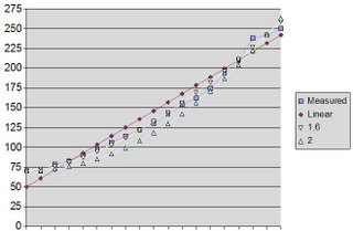

Monday, August 21, 2006
Unfit Curves
Assuming the data that Forrest gave is typical, it appears the motor velocity vs PWM is anything but simple. I've tried a few expressions, and the one that came the closest is hard to explain (There isn't really enough data points or test runs to come to any conclusions; I'm going on what is available right now.)
The blue squares show the measured motor speed for a specified PWM value.
The red squares are: PWM = SPEED * 16 / 21 + 50
The green triangles are: PWM = SPEED^2 * 172 / 17 + 70
The yellow triangles are: PWM = SPEED^1.6 * 172 / 17 + 70
Very puzzling. In any case, it appears it won't be easy to try to get exact equations of this nature.

Anyhow, I did a test series to determine how much overshoot we were getting when we detected a stopping point. Here is the raw data.
I also did a 5-point smoothing on the raw data so that it was easier to see the curve.
Beagle! If you want to use this as input for your cubic splines fitting you can either get the data off of the Raw Data chart (the motor speed pulses are integers) or give me a shout with your email address and I'll shoot over the Excel file to you.
Oh yeah, the sampling period is 0.2 sec. That works out to about 42.5 rpm for a top speed of 17 pulses/sampling period. The reason that it isn't higher is that this board uses 5.45v to power the GM4.
The max voltage you are supposed to put to the GM4 is 6v which is supposed to get you 70 rpm. I didn't want to risk making a mistake and burning it out by using 12v input and then trying to limit the speed range to stay under 6v. I didn't know that H-bridges eat a few volts off the top of what you feed into them, so as a practical matter I'm really only getting about 3.65v to the motor after I run it through that 754410 dual Darlington chip. Now that I'm confident that what I've got works I'll build another board with 12v going into the 754410 and trim what gets into the GM4 in the firmware.
It's worth noting that even if I don't try to compensate for the overshoot that would get me a max error of 6/256 or 0.023 mm for a straight threaded rod positioning system. If I hook it to a pantograph linkage like I plan the error will multiply by whatever multiplying factor I set the pantograph to give me. Kicking it up to 6 mm/sec would give you an overshoot error of 0.2 mm at maximum speed. It's obvious that we have to compensate but it's also obvious that we don't have to have a very sophisticated compensation algorithm to hit our 0.1 mm accuracy target.
Supposing that I build up another GM4 controller that uses 12v instead of 5.45 I can expect to get a maximum rpm of 70. That would mean that the scaling factor to get 6 mm/sec with a pitch of 1 mm/turn gives you an overshoot error of 0.12 mm at a maximum translation speed of 6 mm/sec.

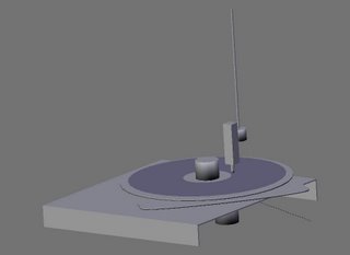

Okay. Here is a sketch of a dual disk concept. I've left a lot of detail out (for example, how the extruder head might work -- it would need to be attached to something above the work space, or to a part that straddles the base with enough clearance to allow the inner disk to rotate the ~45 degree span.)
I'm not sure if it is an improvement or worse than a threaded model; but I thought I'd throw it out there anyway. Some of the problems that it might have:
- friction between the plates. What is the coefficient of friction for two plates of plexiglass split by a layer of vaseline?
- mounting the motor to the plates. I've sort of made this abstract, but I think it could be done.
- donut print area ; As you get closer to the centers, it becomes a lot harder to control (one motor has to be driven uber fast, the other, uber slow; it seems rather than trying to fix the singularity, just don't go there). I figure the ring form would allow a reasonably wide variety parts to be made.
- available resolution varies : the resolution at a point will be different for different angles. As you get closer to the center of the top disk, resolution in the direction of it's rotation will be higher
Some advantages:
- It is a reasonably small footprint for the size of pieces it can make.
- It would be relatively easy to add a 2D motion sensor to monitor the top disk motion (Upside down optical mouse mounted beyond the radius of the inner disk.)
- It should be pretty easy to build the XY axis. The Z axis would probably still be a little more difficult.
Here are a two wireframe top down images that show the range of motion of the center disk (The top disk is allowed to rotate 360 fully.)
The extruder nozzle is the square/triangle pair near the top.
An outer disk with 30cm diameter would fit on a frame of about 40cm square, and could print solid cubes with a base about 10cm x 10cm, long rectangular pieces of about 2cm x 25cm, and of course, larger hollow pieces of up to about 30cm in diameter.
Oh, and here is how you would add a second print head (click for a larger image). This would not allow you print two parts at the same time (you'd need a second top disk for that), but could be used to fill with a second material
**** HOW IT WORKS ****
There was some confusion as to how this XY axis would work. In the drawing here, I hope you can see how you could move any point in the ring under the extruder head. Look at just the green lines for a moment. If motor A were the only motor turning, you would form the arc of a circle between the two darker green lines radiating out of the center of that circle. If motor B were the only motor turning, you would get an arc of a circle between the two darker green lines radiating from that circle. If both motors were running, you would get some curve (or line, if you controlled the motor speeds accurately) that represents the sum of two circular arc vectors.
The same would happen when moving along the blue line, and the red line. I think it might be easy to visualize if you turn the two disks into lines, put the extruder head out on the tip of the line, and pretend that this is above a working surface --> You get a robot arm. If you reverse the concept, and put a working surface on the robot arm instead of putting the extruder on it, this is what you get.
Here you go...
