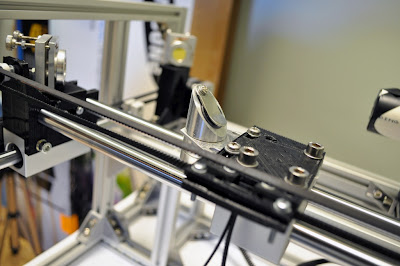

first tests building a selective laser sintering printer: part 3
Hi folks,
This is just a quick post, but I thought I'd post some progress:

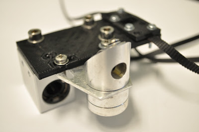

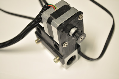

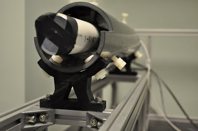

The ball-joint system that I'd thought up for the pan-tilt mirror in [part2] was a bit haphazard and didn't work very well, so I decided to rethink the whole thing. A gimble would be idea, but placing the steppers right on the gimble axes wouldn't yield a workable resolution, and would need some gearing to make it work. To keep things simple, I wanted to figure out a way to use lead screws (to get that extra precision), without having to worry about printing some gears out.
I was trying to think of a simple system that would allow you to use a lead screw with a gimble, but there are tricky issues where the motor itself would need to pivot. I left the idea with my dad for a week (especially so I wouldn't be tempted to work on it instead of my thesis), and I'm pretty impressed with what he made. There's still some backlash in the nuts, and ideally you could use even smaller steppers (or, servos, if you could find some really tiny, really high resolution ones), but I think it'll work just great for testing!
Right now I'm tinkering with ideas for how fresh material will be delivered over the build chamber. I'm thinking simple, inexpensive, and easy to make... make your mistakes cheaply, after all...
alt=""id="BLOGGER_PHOTO_ID_5447959549545405538" />
this last one is a 2 second exposure, where the simple square that i coded into the dsPIC controller can be seen (though it's a little blurry). The test square is about 100 steps on a side, and that translates to about 1cm of travel from about 10-15cm high -- so if the mirror assembly is around 5-10cm up, there should (hopefully) be plenty of resolution for the ~1 inch diameter build chamber.
